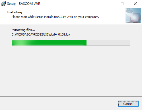

Now the files will be installed.
After the main files are installed, some additional files will be installed. This depends on the distribution.
These additional files can be PDF files when the program is distributed on a CD-ROM.
